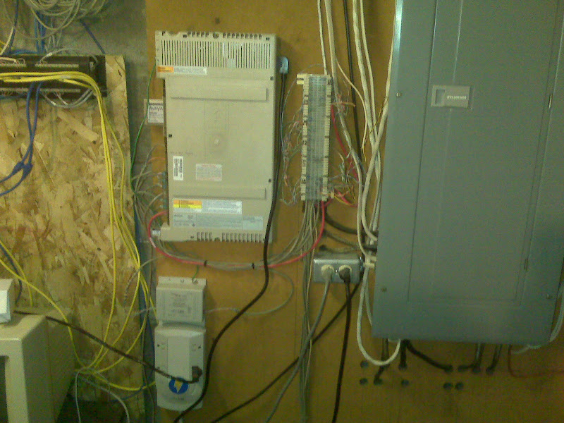

The image below is the closest thing i could find to what I saw today...
A sub-panel, no guts, not breakers, and a new run of 1 1/2 inch pipe completely full to the brim with 12AWG THHN going to a another panel.
I'm talking spider web mania!!! When you take off the panel cover, the wires in the panels are woven together just bunched then pushed into the panel with their associating wire nuts right-side-up, up-side-down, and everywhere else, having a less than attractive bouncing "spring" effect when touched.
Besides the obvious fill violation I have two questions:
1)Is there anywhere in the NEC that has codes against "ugly" work.
2)If not, could an inspector have anything to say about the panel itself being like that, being a huge junction box, and not orderly?

#1 Ugly or beauty is in the eye of the beholder
#2 An inspector may not like it but in reality most J boxes are tangled and mangled wires, some just have more than others.
There is 110.12 but the TCC has pretty much stated that it is unenforcible.

You couldn't have an NEC code against "ugly work" any more than you could have a law against being a bad person.
Rules and laws must be clearly defined. There are laws that will prevent someone from being a bad person but these laws are against specific offenses.
There are certain rules that can prevent certain ugly work but the rules cover specific installation methods. As you mentioned, conduit fill would be the place to start with cleaning up this mess.
An 1 1/2" conduit filled with #12 THHN conductors is going to be detrated so much as to make them useless. We are talking about a conduit run and not a short nipple, right?
