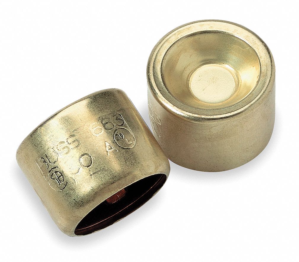

    What exactly is an irreversible crimp when reffering to grounding connections? Can anyone give me an example, part number, visual? What makes a crimp irreversible?

    Yeah, I've actually been to that website before, but I can't seem to figure out the meaning behind the word "irreversible".

    It just means the connection is "permanent." Once the connection is crimped, they can't be un-crimped.
    The irreversible compression connections use special dies and purpose-built crimping tools (such as Burndy's) with each compression having an embossment to ensure it was properly set.
    These connections are superior to mechanical grounding connections, which typically build-up in resistance over time. These connections, provided they were properly crimped, offer low resistance over a long period of time.
