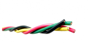

Every submersible well pump I have ever worked on goes like this there is a little 'pumptec' control box:
Then the well guy has one of two twisted cables typically THW (non direct bury has to be in conduit to the well head) or the more expensive cable that is UF single conductors twisted together both look like this:
Breakers are usually a 2 pole 20 & 12 or 10 AWG wire. Sometimes you see #8 on a deep well.
3rd yellow wire that goes to the pump to start it.
