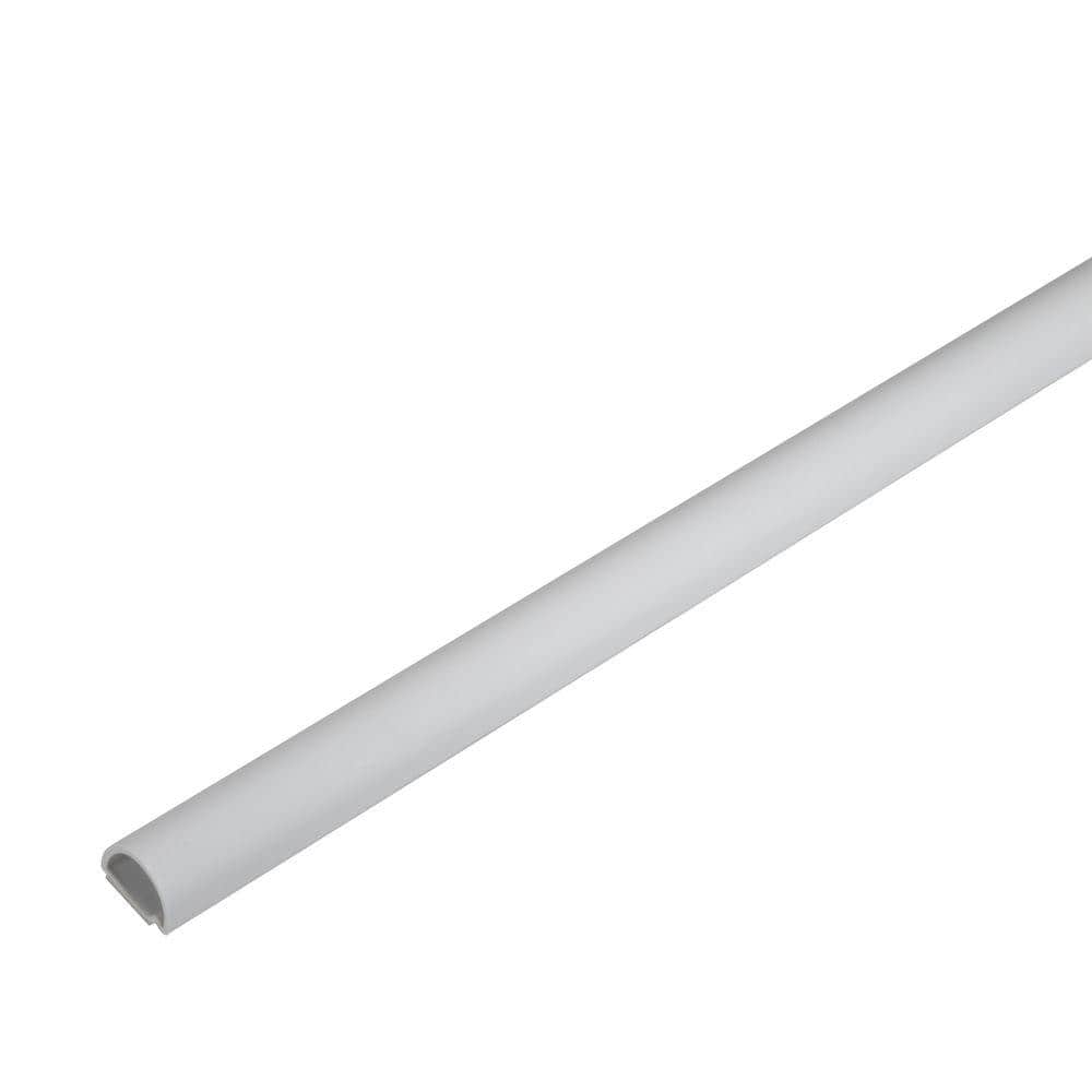

Hey that track you have your low volt feed in looks pretty slick. Can I ask what your using and where you got it
