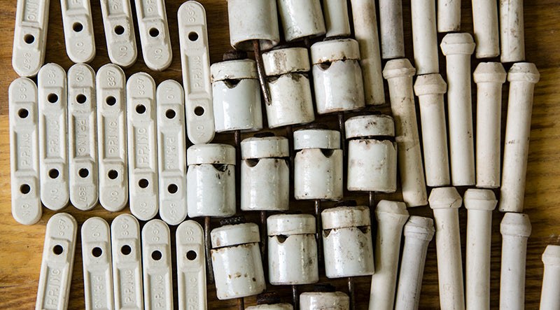

Ok, so what if we did a MWBC with K&T and used a fused disco where the circuit originates :LOL:
