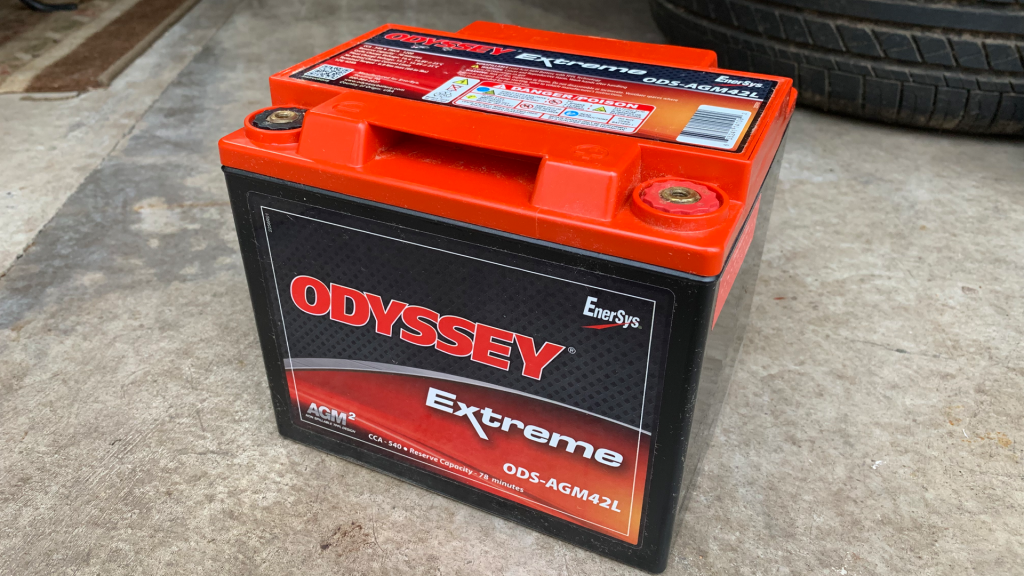

I have often heard that automotive batteries should not be stored directly on a concrete floor, because concrete will suck the charge out of a lead-acid battery and deplete it. I've often seen batteries stored on a concrete floor with a barrier of wood or newspaper underneath them. I never did get a satisfactory answer about how the concrete could suck the charge out if it isn't in contact with they electrolyte or plates.
I do think I know where this half-truth originated: If you store a battery directly on a concrete floor -- in an unheated garage, without a maintenance charge, for two years or more -- it will go dead due to internal self-discharge. (and during the third winter, it's likely to freeze solid and self-destruct)

Here's an explanation of that myth
