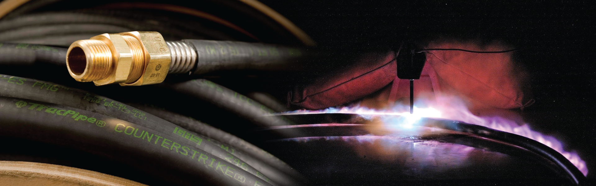

Further, because CSST is supplied and installed by the plumbing contractor he would be most familiar with what it requires. The new black jacketed CSST for instance does not require bonding. Therefore, it's not our responsibility to furnish the bonding but rather the plumbing contractor. That's why it's not in the NEC. Not our job.

In MA. I believe the plumber/gasfitter is supposed to hire an electrician to do the bonding unless it is the CSST with the black coating "Counter Strike" is one brand that does not require bonding.
Other than that as others have stated the gas pipe is bonded by the gas appliance electrical feed.

I feel it needs to be bonded, but the black jacket stuff doesn't have the more complex rules the yellow jacket stuff has. IOW treat it about the same as you do black rigid pipe when it comes to bonding - the EGC to the appliance likely to energize it is sufficient to do the bonding.
