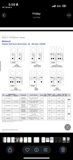

I looked just now but didn’t see anything rated for 200 amp
They have several models with feed thru lug assemblies, metered and un-metered with lugs up to 350kcmil, single and dual head.
Each section has up to 125A rating and Short circuit current withstand rating 10,000 RMS

If I understand correctly you would only be able to feed/loop through 3 pedestals fed from a 125a circuit.
Or are you saying you could feed this with a 200a circuit? And loop 4 to 6 sites out?

You need to contact the manufacturer and find out from them what the pass thru lug block is rated for.
I don't see why you couldn't string as many of them as needed along a run, as , long as you keep the over current protection below the pass through block and wire rating. The 125A rating is just for the upper section, wiring and bus section. The lower section is where your pass through ratings apply. Ask the maker what the ratings are for the model you select.
