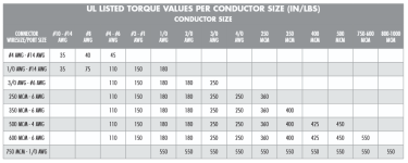

I work in jurisdictions that require demonstrating torque on every job, or at least a video of connectors being torqued with a tool.
But there's been a big problem with old aluminum feeder wires in apartments.
When torqued to the NSI/Polaris specifications, the bolts simply tear the aluminum conductors.
For example at 180 in/pounds for 1/0 AWG stranded aluminum.
This has been a problem when the AHJ insists on seeing a live demonstration of torque on the connector, and it tears.
You don't get too many chances on this, as these wires come out of the wall without a whole lot of slack.
Split bolts like the APS06 have similarly difficult to achieve torque values, but the design of a split bolt does not dig at the old cable quite as much.
Anyone deal with this situation and found a solution?
What do you mean by tear into the conductors? Are they completely sheared off? Is the problem the fact that the conductors are old?
With NSI Polaris connectors, there's no plate that the screw pushes on, that then pushes the wire.
The screw directly rotates against the wire. In the ones we've done the steel screw literally mashes the wire a to pulp. The aluminum is the 1950's 1960's 1970's era stuff which is pretty brittle to start with.
That much torque is not doing what the AHJ wants it to do. Not a good connection
What does the inspector suggest when he witnesses this happens?
Depends of course. "Just get it as tight as you can" for example.
What the hell can they say, other than "use part number APS11 instead" maybe. They are not working electricians, they don't know.

Normal mechanical lugs don't have a plate, They screw directly contacts the wire.

Crimps, pressure plates and appropriate split bolts.
To clarify, I wasn't suggesting Noalox on the screw threads, but on the conductors themselves. That would reduce friction between the tip of the bolt and the aluminum, no?
For example the set screw design Polaris Vision #IPLD350-3CB
As opposed to the Square D QO design which compresses the wire, rather than bite into it. Click for full size image.
Supply house I use has more Burndy connectors of this type than Polaris. some of them are rated for fine strand conductors. Major difference is they also have a plate to compress the conductor instead of direct set screw contact which would lessen chances of damaging small strands and possibly would give you more success with OP situation I would think. The Burndy ones have the suffix-FX in catalog number if they are rated for fine strand conductors.
Nolox would set things back in this situation.
The screw is pushing the stranded conductors apart first, then destroying them.
What's needed is crimp or clamp.
