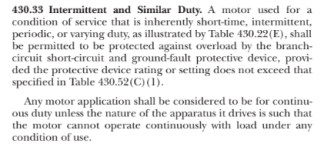

Wiring a car lift for a small used car shop. Odd size motor, 2.5 HP, 13 FLA 230V single phase. Not thermally protected. Can't find any overload/starters that match this range, and am hesitant to start rigging 3 phase starters for single phase, as I hear often mixed success with this. I was thinking of having the breaker be used as overload protection because it is intermittent duty and used sparingly. Disconnect switch would be mounted on the wall next to the lift, then piped over.
The service guy I called at Mohawk says most guys just run plug and cord. To be honest, everyone just wires these things cheap as possible, but I'm not going to violate the code for convenience. Just wondering if anyone else has experience wiring lifts before and if 430.33 lets me use the breaker as the overload.

This application doesn't even require motor overload protection. Every one I ever seen was a intermittent duty rated motor. By nature of the operation they are an intermittent load anyway they all have a momentary contact button and you must hold to run the motor. They don't run long enough cycle to even trip normal motor overload protectors. If motor stalls or fails to start for some reason you are right there to let up on switch and if you don't it will trip your short circuit/ground fault protection within a few seconds anyway.
Check this section out:
