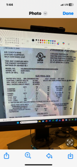

My question is about reducing the voltage of a transformer. What happened is, a heating company replaced a comercial root top unit. Heat and cool. The problem with Chicago’s electrical grid seems to be the imbalanced voltage. We have a 240 volt, delta, 3 phase service. The manufacturer of the equipment is Trane. The equipment has a VFD drive blower. The VFD can not take the unbalanced power. My solution was to intercept the the wires feeding the blower and connect them to a transformer. The transformer is a 5kVA, 240 delta primary with a 240 Y secondary. Now Trane is saying that the moter is not getting up to speed because it needs 208 Y. So, is there a way to get 208 out of this transformer? Meaning connecting the line side to different tap conductors, or any outer way?
The current readings are line side 125, 125, 215 phase to ground. 250, 250, 225, pause to phase. The Load side readings are, 140, 140, 140, phase to ground, 250, 250, 225, phase to ground.
Picture 1, is the transformer label.
Picture 2, is the scep sheet of the RTU
Pictures 3-6 are the technical label on the transformer. Sorry, but no matter what I did part of the label was unreadable, so I cut it up.

looking at the nameplate of the unit you posted its hard to read but I think it says
Trane YSJ090
thats a 7.5 ton gas/electric series, and for YSJ090A3 the electrical table lists 208/230 V, 3 phase,
MCA 42
max fuse / breaker 50.
Input voltage range looks to be 187-263 volts 3 -phase
If I am reading that right according to my old Trane book it should support 240/139 wye,
if the unit needs 208V as Trane tech support suggests Trane needs to send you a new nameplate.
I would also be surprised if they suggested the transformer configuration you have.
If the nameplate is indeed correct, I suspect your issue is the Compressor VFD, can't run off a 240 (likely open) delta or whatever your utility does, you likely need a transformer sized to the entire load like a 20kVA 240: 240/139 (at minimum) and that would need to supply the entire package.
Since more and more things don't support 'delta' services I'd ask the utility if its possible to convert to a wye service such a 120/208
or if the building has mostly 240 3 phase loads and not much 120 you might explore other options such as settings and jumpers in the VFD that may make it run better on a delta supply.

Funny: The transformer label says 'Primary 240V Delta' but the data plate says it is a wye:wye transformer.
I don't think you can use a wye:wye transformer to derive a low impedance neutral for drive isolation because they don't develop a low impedance neutral.
The wiring diagram shows a wye connected primary isolated from the wye connected secondary. As long as the primary wye (H0) is not used, as a Yg-Yg, the secondary neutral would look just like one created by a delta primary.
Say you ground the secondary neutral, and then have a ground fault on the secondary side.
Where does the current flow on the primary side? Remember that except for magnetizing current, current doesn't flow throw a primary coil without current on the corresponding secondary coil.

I wouldn’t say they recommend this set up. This was my way of solving the problem. It is the evaporator motor. Or should I say, it’s the motor that blows thru the coils. The reason I did this was because the transformer for the whole unit is a lot more money. I did and experiment with the unit next to this one and it seems to have worked. This 2nd one won’t. They have replaced the VFD, the board and everything. So they say. Now they are kicking it back to me.
It is an open delta on the line. But the output is supposed to be balanced Y 240.
Ive looked at that plate a dozen times. I didn’t see that. Wye on the input. That might be the problem, yea?
Meaning that is why the secondary has the different phase to phase readings? The line side high leg is used.
YASKAWA dealer here:
Another way to deal with this issue is to use a line reactor and input the drive as single phase, (using the balanced phases) with three phase output on the drive to the motor, you can also lower the voltage output to 208. This would require replacing the drive with one that is rated 2x of the motor load. I know this gets expensive and you already have the transformer, but it's the wrong transformer. 208 cannot be made through changing taps.
Before i even attempt this, I was thinking swapping the transformer with a 208 secondary. It would take a learning curve to figure all that. Thanks
