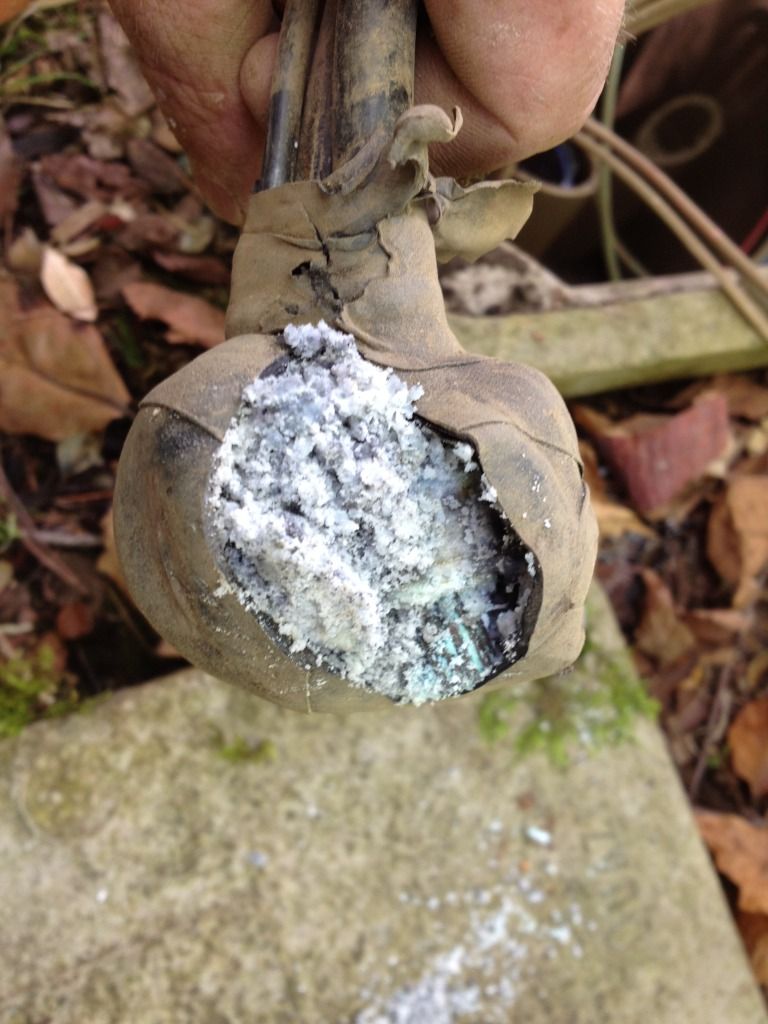

Trouble call was reported as Motor Operated Gate stopped working.... This is what I found. :)
This is what happens when you use AL. split bolts in wet locations, and by the way, there were about 6 of these in ground junction boxes with no drainage provisions...
