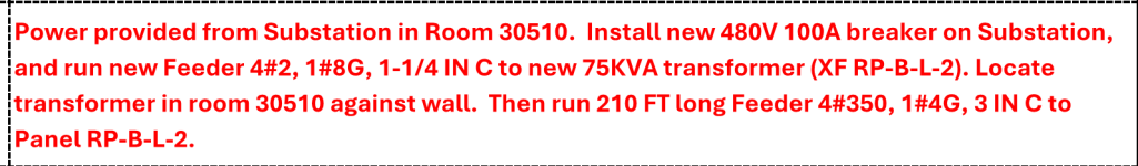

A friend of mine works in a facility where they use fusible disconnect for the transformer protection and he will always specify a 100A fuse for a 75 kVA transformer with a 480 volt primary. The 100 amp disconnect is cheaper and physically smaller than the 200 amp one that would be needed for 125 amp fuses.
If we're talking about a VE opportunity... mount the transformer close to the secondary. The 350's will need upsizing for voltage drop as well with it 210ft away. If you can't move it, you'll have to put a fused disconnect on the secondary next to the transformer.
Also, don't need a neutral conductor on your primary side.
Yes, I did notice that about the neutral

What if this is located outside? Wouldn't 240.21(C)(4) apply?
There's nothing to indicate it's outside, but if it is, 240.21(C)(4) only applies if the feeder is outside and then into a building. In that case, you would need a disconnecting means on the outside of the building where the conduits stub in.
