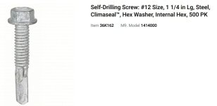

How about fine thread self-drilling screws, strut - if needed, and minerallac straps?
