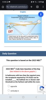

If code allows boxes to be supported by ceiling grids up to a maximum size but not support the wires, then why dpes the pic not show the wires being supported and secured by the main ceiling support?
Wires laying on drop ceiling grid
