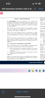

A quick Google search found this web site. https://www.sonicaire.com/unraveling-facility-classifications-is-yours-class-ii-rated/ . The main reference is 499. Another search confirms that corn dust is combustible, so 499 will give you the parameters to determine a layman's classification of the area. From there is would require a "qualified person." That could be you.
NFPA 61 explains it’s up to the owner/operator to do the classification if I’m not mistaken. I’m not qualified to classify hazardous locations even though this one is pretty obvious.
