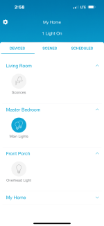

What are your favorite go-to wall light switches? I see Lutron has one that is for no neutral but requires a bridge of some sort?
All I need is to be able to turn office lights on or off from a phone. No dimming. Employees leave lights on in the upstairs offices and the owner wants to see whether they are on or not, and be able to turn the lights off with his phone from home.
Lutron works well, yes, you need the hub, but has pretty good range. I believe it uses Bluetooth. I set up a heavy equipment repair shop to where the owner can shut off the air compressor and lights if the employees left them on. (You can also see if they are actually on)

Th Lutron Casseta app will show if they are on or off in the app. He would not have to drive by.
That’s what I’m wanting. What started this question is he was riding by on the bypass and saw his office lights upstairs on from a distance.
