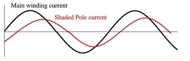

For the motor to start, we must have a "rotating" magnetic field. This is where the shaded pole comes in. Since the shaded pole receives its current through induction, and since the shaded pole loop has different resistnace and reactance than the main windings, the current in the shaded pole will be out of phase with the current in the main windings.
Here is a diagram of the two currents:
Say we turn the motor on and say we are at the positive peak of the main winding sine wave (black). Let's say this creates a north pole at the top of the motor. The strongest magnetic field is going to be impressed from the main pole north at top to the main pole south at bottom, essentially the flux lines are vertical. But as time passes, the main pole current becomes weaker, and at some point the shaded pole current becomes stronger than the main pole = the shaded pole magnetic flux is stronger than the main pole magnetic flux. This would occur around the place where the "S" of the word "shaded" is in the diagram above.
Note that when the main pole current is zero, there is current in the shaded pole. So, the main pole magnetic field dies off and there is no longer a north at the very top of the motor. But the shaded pole current is still there.... and now the north magnetic field exists at the shaded pole. Essentially, the north pole has "rotated" from the exact top of the motor to a bit right of top. The magnetic field "rotates". And this is how a shaded pole motor starts.
