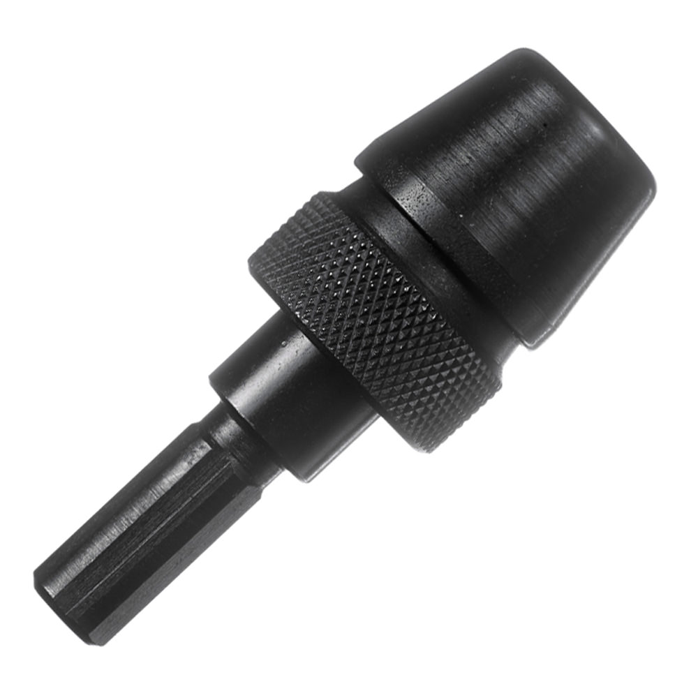

So we do a lot of 3/8"-16 drilling and tapping for installing grounding servit posts. Saw that Champion has a combo bit for quick change impact guns. So I bought a few to try them out. Turns out that for their 3/8 inch drill/tap, the quick change hex shaft is 11/32 inch, not the usual 1/4 inch !!! Never heard of such a thing ...
Any idea where to find an adapter so I can use this bit in a 1/4 inch impact gun? Yeah, I know, I can put it in an impact drill or use a 1/4' quick change with a drill chuck, but that kinda defeats the purpose of having a bit that is quick change to start with.

Never saw one myself. Maybe use an 11/32" socket?
Yes, but the tool is shaped just like a 1/4" quick change bit, only 11/32". But what in the heck would it quick change into? (Uh, it's the weekend. Surely to be some "quick change into ... " comments)
I have no idea, but I would just put a drop of super glue in an 11/32" socket and be done. That way it would come out in the future easy enough to replace and you wouldn't have to go looking for any specialty tool like an oddball quick change.

Well, I got a 1/4" quick change impact and also a 3/8" square drive impact. I ordered a couple 3/8" drive 11/32 deep impact sockets, and we'll see. I don't really want to set this up with the more powerful 3/8" impact gun, though. See, I get different "helpers" that aren't provided / don't have their own tools. They break a lot of stuff ...
For my drill-N- taps I use a 1/2" Jacobs keyed chuck, and don't tighten it, fully tight. which allows the bit to spin, if it binds on the chips, in the hardened chuck jaws, preventing breakage of the expensive tap, off in the expensive work piece.
I don't use impact tools for drilling and tapping. The tooling is too expensive for that kind of treatment.
I have used Regal drill-n-taps for many years with this method, they are hard and brittle and will break easily if driven abusively, but can last a very long time if used with care and a few drops of cutting oil.
I would expect that Champion ones jump up to the 11/32" shank at the 3/8-16 size and above, is because the 1/4" quick change hex shank would break off at the reduced shank area, in the chuck, with the torque that is required.
I used to break the standard drive ones off when using them, till I learned to use the drill chuck as the torque limiter. Especially on the smaller sizes.
I haven't broke one off in several years, once I learned to use the keyed chuck for torque control.

Did a couple holes with the Champion 3/8" drill-n-tap. What worked well was a battery operated hand drill on slow, but with the hammer drill selected. Didn't feel it was straining of binding or anything.
I still wonder what the heck this 11/32" quick change shank is all about.
Hammer drill setting is definitely not a good idea for drilling or taping metal. Its designed for masonry.
