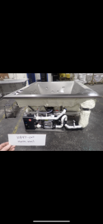

I am wiring a large custom home in Montana and our spa specifications came in at a whopping 125A 240v feed for a main control panel mounted to the hot tub. Does anybody how one would GFCI protect this? Likely the designers will not go for a large 200A 3R fused disconnect sitting on the side of the house so I am proposing a shunt trip style breaker enclosure in the mechanical room with an emergency stop mounted outside… My problem however is how to GFCI protect this spa?
The feed for the spa is called out from a 400A Single phase 240 Eaton bolt on style panel. BOB breakers not the expensive molded case style.
Has anyone seen a BOB GFCI 125A breaker? I cant find one from cutler hammer/eaton. If it is out there, would a shunt trip breaker downstream interfere with it? I haven't done a shunt trip for awhile now but I recall 120V with a neutral being used. Would a 125A 240V contactor make more sense than a shunt trip for this scenario?
Any recommendations on how I can GFCI protect this large load and avoid putting a chunky disconnect outside? I already know the designers are going to lose their mind over one, if it was my place id be shooting for a small E-stop too.
