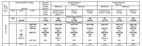

IF you have a 220 volt Y would be 220 volt from line to line and 125.4 from line to neutral !
Here is the NoM equivalent of our ANSI C82, looks like the maximum is 133.3, not 139 as I thought. Our max is 127;
Granted these are just utility standards, not code per se.
And the us ANSI C82
