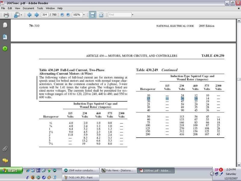

Looking at T430.149 , a 15Hp motor @ 460v is 18A.
That would be a rare motor...that table is for two phase 4 wire motors, however if you did have that motor the code would not permit the use of #14 unless the terminations and equipment were listed for use at 90?C. 1.25 x 18 = 22.5A.
Now Im using 2005 -NFPA.
Now I'm trying to play along here at home, I ususally go right to the stated article(s). where's 430.149 - table article or other.????
Maybe its 430.249! ?

I really need to get out more if you guys are hooking up 480 Two-Phase
Alternating-Current Motors (4-Wire).:grin:
Sorry.
The '02 NECH just looks so much nicer than the '05 NEC.:roll:
I've really got to start (at the very least) referencing the edition NJ uses: '05.
Both tables are the same with the exception of the table number.
Good catch!
