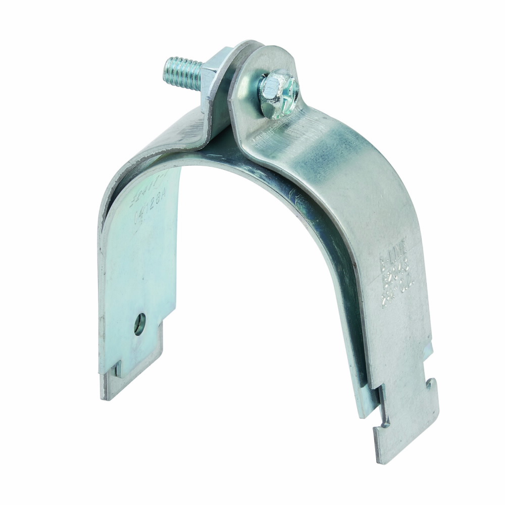

Hello does the NEC say anything about securing RNC (PVC) to unistrut? I inspect industrial electrical projects. I have always used rigid strut straps, but is there an issue with using a 1” EMT strap? Is there some UL listing issue/NEC issue?

And the strap would be listed or labeled by the mfg for the conduit type allowed.
Depending on the length of the run, a regular strut strap may or may not work for the expansion/contraction that will take place.
We use a lot of regular strut straps on stubups into the bottom of enclosures, but use other means where the conduit has any distance to it.
as Tom mentioned, NEC requires it to be listed for use with PVC, which regular strut straps are not. They do make some plastic ones but they are easily broken. Are you the AHJ in your area?

There is no requirement in the NEC that straps be listed. The only listing requirement for supporting is where tie wraps are used to support flexible wiring methods. There is a specific requirement that the strap for PVC be designed to permit the conduit to move, but it does not require that strap be listed.
The B-line B2417 series of straps are designed to permit the required longitudinal movement of the pipe. I have never used them for PVC, but we use them were there are expansion joints in rigid to permit the required movement. It doesn't make any sense to put the expansion fitting in and then install the conduit is a way that restricts the movement. The inside part of the strap is slightly larger than the OD of the conduit and permits the conduit to slide.
You are correct. I didn't actually re-read the article just from memory on a somewhat recent project. The point I was making was that standard strut straps wouldn't work for this requirement.
