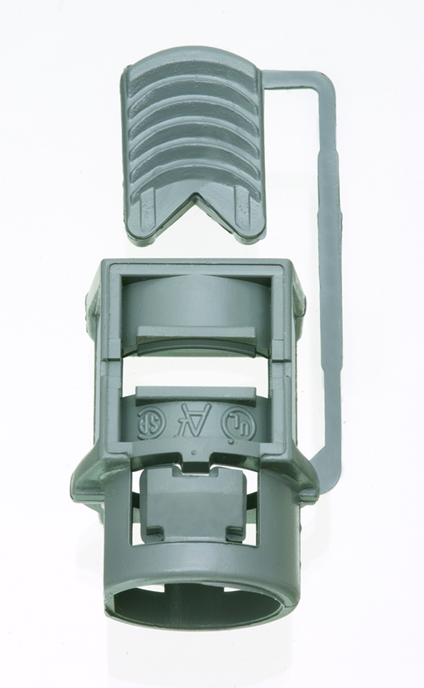

A new Inspector almost failed an in-wall residential panel change of mine today for using a 2" SER connector to bring several branch circuits into a panel. Said it's not UL Listed for that application. I was not at all sarcastic with him, but it's literally called a non-metallic sheathed cable connector.
Now, I did read through several threads and I saw that folks have described it as lazy and whatnot, but I only do that for the 120V circuits, 20A and less. Everything else goes in it's own plastic NM connectors. I do this, as a means of securing the cables and strain relief.
I always thought that the derating rules only apply on entering an enclosure with a nipple 24" or more. Shorter than that, all is well. Connectors included.
I discussed all this with the inspector and he couldn't cite me a Code reference but what he did say, is that he would accept a chase nipple (or a PVC connector) so long as the cables didn't take up more than 60% of the space. Which honestly, blew my mind even further. No securing of the cables at all, save the staples.

Those connectors are designed for a cable of specific size not multiple smaller NM cables. The inspector should cite 110.3(B) for the violation.
Example: https://www.gordonelectricsupply.co...wry_RDz6IJMVidJfMiBO-B99nSnIQlaQaAsXrEALw_wcB
The Arlington connectors linked to in this thread are clearly listed for use with multiple smaller NM cables.
http://www.aifittings.com/reference/files/pdf/charts/nm-cable-ranges.pdf
Provided you used an Arlington -brand fitting, I'd argue that you would be code compliant based on the documentation Arlington has provided.

I'm leaning toward the opinion that some of those numbers are incorrect. It says 10-12/2 cables but only 9-14/2. And this is not a two screw squeeze connector it's one of these. Can you get 10-12/2 cable in there and still crimp it shut?
I agree, and I'm not sure I'd want to try. I was simply stating that according to the directions, I believe you could.
Just because you can, doesn't mean it's a good idea. :)
I wonder if the 2-screw clamps have any similar allowances. I can't find those on Arlington's site right now.
