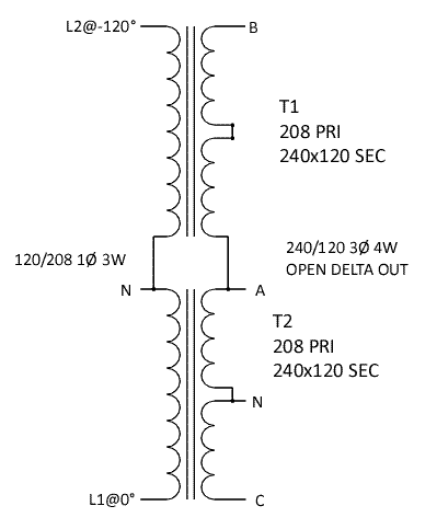

My customer wants to run a Heidelburg press, 3 phase motor, 1.65Kw, wired for 240 volt operation. His shop was wired for 120/208. He has a Roto-Phase converter Model M (Max total HP = 7.0). It seems that he may need one or two buck transformers to raise the input high enough to run the Phase converter. I have not installed buck transformers and am not sure if they simply are wired in series with the input line, or what.

The Heidelburg press: Previous installation was served by 120-240 4 Wire. The 3 phase motor is made by Siemens. I have communicated with them and they say: "This motor cannot be run at 209, you must use 230V". It does include a control system which needs 2-wire, 120 volt.
The shop: Is located in a complex of eight small businesses. The initial installation was supposed to be 120-240, 4 wire, delta. But it turned out differently. All businesses have single phase, 120-208. I've interviewed some of them and they don't realize that they have 208, not 240. No body every cared until my customer came along, with a three phase press. To properly supply this customer, the power company would have to put in a 3 phase meter, and run another wire the length of the building. Not going to happen.
ARCO has supplied drawings that show how to install the Roto-Phase with a Buck/Boost transformer.
I'm uncomfortable with the neutral situation and the single phase control feed.
The customer already has the Roto-Phase. By the time he pays for a buck/boost, a mag. starter, disconnect switch, cabinet, and wiring he is going to be in for a lot more bucks than he figured on.
Thanks again. All advice gladly accepted.

Aside from sizing and availability, what do you think about a two-transformer solution?
You list your transformers with 208V primaries but you are connecting them to 120V sources. But yes, in theory, you should be able to go from an open-wye to an open-delta.
Smart$,
That is almost exactly the configuration that I was going to suggest. However I believe that the transformers need to have 120V primaries, not 208V primaries; the L-N voltage is only 120V. Also I believe that you need to swap the polarity of one of the transformers; as drawn you have an open wye to open wye configuration, with a center tap on one of the legs of the secondary wye.

In any case, if the 3 phase load is really only 1.65kW, you can produce proper 3 phase 240/120V with a grounded center tap, using a couple of small transformers.
Ooops.... I was in a rush to get the drawing done. Nonetheless, you are correct, it should be 120V primaries.
...Also I believe that you need to swap the polarity of one of the transformers; as drawn you have an open wye to open wye configuration, with a center tap on one of the legs of the secondary wye.
Are you sure? The primaries are wired reversed polarity. Note N connects bottom of T1 primary and top of T2 primary. In essence, that inverts the L2-N winding from -120? to +60?. See diagram below (primary voltage corrected)...
