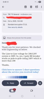

Doing some apartments with a 120/208 3 phase service and 125 amp 120/208 single phase to each apartment.
Having trouble finding any of the usual panel manufacturers with 2 pole GFCI breakers rated for 208v.
What are you guys using for something like this?
Interesting. We won't be needing any 2 pole AFCI. Just the GFCI for the dryer and range in some of the kitchens.
I got a support request in to Eaton and Square D, so if they ever reply I'll post what they say here.

Yup. Couldn't think of any reasons it wouldn't work, just trying to avoid any headaches with inspectors. It's my first time dealing with 120/208 in a residential setting like this.
Eaton confirmed their BR GFCI breakers are compatible with 120/208.
