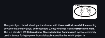

Interesting find, and that diagram seems to show the exact sort of series arrangement suggested by the original diagram. The upper transformer uses the |||/wye icons, but is labeled star/star. The lower transformer uses the wye/delta icons, labeled star/delta.
