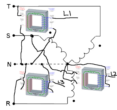

If the service is 120/208Y then the BB needs to match that on it's input, regardless of N. If i stick a BB on each phase (L-N) and boost each to 136v, ph-ph on sec BB side will be 240v. My Q is, if the BB sec is a coil then does one side of each sec coil get tied down to the Y N making a common ref point for it all for the BB xfrme to boost, but then I just take one wire from each BB as my L to the equipment (L1 L2 L3)?
like this, which is basically a mini step-up 120-->138v xfrmer on each phase of 208Y using common N for the coils. L1 L2 L3 would be brought to the equipment.

FionaZuppa:
I can not understand your diagram. But I don't believe you drew a circuit that would be described as a boost circuit.
A boost circuit using three transformers to create a balanced wye system would for each line to neutral phase have the primary of the boost transformer connected from its line to neutral and then its secondary would connect from its line to the new output line so phased that the voltages add.

the 208Y has X Y Z N, N being common to X Y Z. XY YZ ZX all measure 208v. XN YN ZN all measure 120v. The ph diff between X Y Z is 120degrees.
I can place a step-up xfmer (primary side) onto XN YN ZN (hence 120v primary), or, I can place the step-up primary across XY YZ ZX (hence 208v primary).
With that said, both setups still have 120 degree ph diff. So if I connected 3 step-up xfrmer's, each xfrmer would have two wires sticking out on the secondary side, so how do those secondary wires get connected? Each xfrmer secondary will measure 240v, so in essence you achieve 3 one ph 138v or 240v supplies, but how do you wire the secondaries so that you can use those secondaries to feed a 3ph delta motor L1 L2 L3?
The pic i posted is a step-up from 120 to 138v, basically a wye-wye step up w/ N as the common to both primary and secondary coils.
