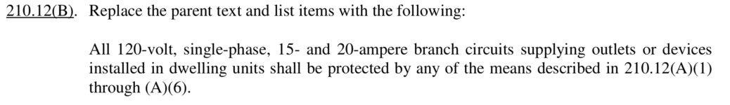

In Massachusetts they amended 210.12 to state the following listed below. It seems there is confusion among electrical inspectors in regards to afci protection when it comes to replacing receptacles located on the outside of the residence. On more than one occasion I had to replace a faulty receptacle on the outside of a house whether attached to the house or in a garden, and the inspector had a different interpretation if Afci protection was required or not. The word “In” is the sticking point. Although 210 refers to branch circuits, and not devices.. I was curious how you would interpret this?

I’m in mass as well , I’ve never come across an inspector with that interpretation. Like you said it reads all single phase 120 volt 15 & 20 amp branch circuits supplying outlets or devices “IN” a dwelling shall be afci protected
In you’re situation 210.12(b) is not the applicable rule anyways, replacements fall under 210.12(e) and mass doesn’t amend 210.12(E) anyways so the replacement would need to be in a location listed in (B),(C) or (D) and outdoors is not one of those locations
If you look at the original 210.12 it isn't required in the 2020 NEC. It is also not included in 210.12(B) of the 2023.
I would show the inspector the classic 210.12(B) and just say "the NEC doesn't require it outside, and the code says "in", so it is reasonable to assume they don't intend to include the areas not within the dwelling unit."

You’re correct when they say “IN” they mean in the dwelling , so if you run a circuit outdoor receptacles and it does not supply any outlets or devices in the dwelling and only supplies outdoor receptacles no AFCI protection in require the situation he described falls under replacements which is 210.12(E) which refers you back to locations in (B), (c), or (D) and like you said the amendment says all locations “IN” the dwelling so it’s irrelevant , the Amendment would have to read “AT” the dwelling

Regardless of whether this receptacle is indoors or outdoors, the simple replacement of the device does not require AFCI protection to be added. Based on 210.12(E) Exception.

406.4(d)(4) is not applicable because outdoors is not a location listed in 210.12(a)(b) or (c)
210.12(E) and its exception are not applicable either this is not modification , extension or replacement of the branch circuit wiring it’s only replacing a outdoor receptacle
There is no rule in the nec or the mass electrical code that requires us to afci protect a outdoor replacement receptacle
406.4(d)(4) says if the replacement in a a location mentioned in 210.12(a) (b) or (c) it needs to be afci protected,
Outdoors is not a location listed anywhere is 210.12 so it doesn’t require afci protection

406.4(d)(4) is the only real reference for afci protection of replacement receptacles, but for afci protection of replacement 406.4(d)(4) says it’s only required if you replace one in a location mentioned in 210.12(a),(b) or (c) and 210.12(b) in mass says afci protection for all 15 and 20 amp 120 v in a dwelling , so if it was anywhere in the house you’d need afci protection at that receptacle , but it’s not its outside and 210.12 mentions nothing about afci protection of outdoor outlets/devices in the nec or mass electrical code

But my whole thing on this is 406.4(d)(4) specifically says if the replacement receptacle is located in areas listed in 210.12(a),(b) or (c) the replacement receptacle needs to be afci protected
Outdoors at a dwelling is not a location mentioned anywhere in 210.12(b) in the nec or the mass electrical code
