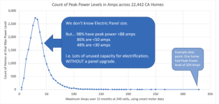

There's a ton of data on this exact issue taken from thousands of homes. And in fact, that data was presented to the NEC committee at the technical meeting stage, resulting in new calc language in the 2026 code cycle.
TL;DR panels have been oversized by those calculations for a long time.
Most of the new formulas made it through the whole cycle, except for one, and that's the subject of an appeal August 18th 2025.
Send a private message I can get you a full summary.
For maximum demand it depends on the PoCo. Identify yours for more help. Generally, you can find it on a bill as a "demand charge" or "peak charge". In some cases, you can download 1- or 15-minute data and find the peaks yourself. However, in other cases you only get 1 hour data which is kind of chancy for making load assumptions.

These inspectors are accustomed to saying that a 100A dwelling service can't handle a 48A EVSE. And load calculations agree with the inspector since they are so bloated and usually come out to 80-85A. But I know that a 100A service can easily handle a 48A EVSE since our houses are all natural gas, and the maximum demand is under 10A.
