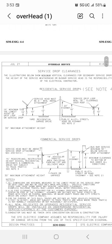

I came across an inspector that violated a 200a service upgrade for
" 2015 MRC E3604.2.2 12' vertical clearance residential property "
I've always went 10' minimum clearance for the service lateral from the lowest point of the droop to grade of a residential backyard if there is no driveway. This inspector is saying it needs to be 12' over residential property even if the area under the wire is not subject to a person driving a vehicle under it. I can see where in 2015 MRC R3604.2.2 it states 12' clearance above residential property and garage driveways. I found a drawing from the utility company showing how they interpret the code or at the very least what they deem a sufficient clearance over a residential property. I've attached a link to the drawing below, any opinions on if the inspector is correct in requiring 12' clearance?
