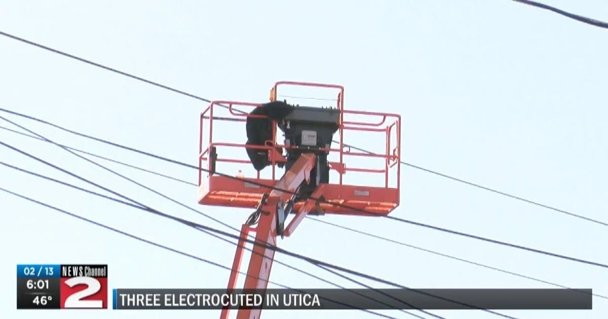

What are NEC/ NESC code violations that resulted in the accident here?
I know OSHA requires 10' of separation from powerlines when using an Arial lift. Not sure what these guys were working on. That being said certain work is not possible to do with that restriction sometimes.
SSDriver
California
Is that a solid 10'? IIRC it's 6' minimum for scaffolding and 9' for moving lifts from 12kv lines (that's the list time I needed to check).
Per this OSHA flyer (not sure how accurate this still is) it just says 10'. IIRC it's different distances for ladders or scaffolding based off of the power line voltage. Either way the picture in the article had the lift inbetween the lines. Maybe they have more strict distances because it's a powered machine and it's easier to make a mistake and hit the lines if too close? Thankfully these guys survived.

Thanks SSDriver. The following lines from the rreport may also need clarification from codes point of view:
....That wasn't the end of the damage caused by the bolt.
"So, it just got worse, it blew a hole into the ground and I thought that was the worst of it and the guys they took them to a hospital and this machine was fried so it was stuck here and I thought it was the end of it," he said. "Then I wake up and we have a swimming pool in our basement and apparently the bolt that hit the ground cracked the pipe that was going into the building also, we didn't know ....."

I was going to say that sometimes it may be difficult to gauge exactly where 10 feet is, but the story says they got within 6 inches of the power line before it arced. They are very lucky to be alive.

They weren't using a spotter either from the report.
There was a ground guy but seems totally untrained. When the incident occurred he went to move the vehicle from the ground controls and he too got severely shocked according other reports. Seems if it was a single arc event and not a direct contact it wouldn't had an ongoing effect to the ground man. How long will it normally take to short the xfer breaker on a 27K line?

Down here, it’s real easy to get the poco to sleeve the lines if you have to work close to them. Usually the contractor is in a hurry or lazy to not have them do it. Could have saved several injuries in this instance.

Or ignorant. You may not know until the first time you find yourself in that situation. I'm doubtful anyone's trying to see how close they can get to the overhead cables to see what happens. I don't know if anyone makes a non-conducting lift suitable for what the crew was trying to do.
