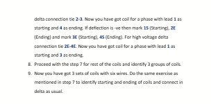

I was going to also look for that article but you found it already.

Here is the procedure for a 9 lead, the methods should be similar for a 12 lead, never done it myself.
You might find similar instructions for the 12 lead, at The frequently asked questions page at US motors given in the attached PDF.
  • Identifying Motor Leads - U.S. MOTORS.pdf
