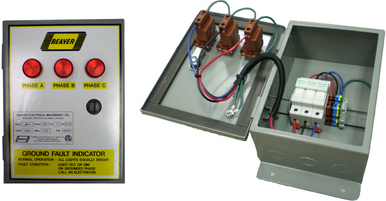

you can also just wire up three lights. the code does not require anything real fancy.
I’m just not sure how to install this since the windings don’t seem accessible inside pad mounted transformer. Also if it were the lights would be tapped off L1, L2, L3 to a common point but there would be no protection for tapped wires
I would just buy a ready made product, and put it on on the wall next to the 480V main,
beaver makes one with simple indicator lights:
There are others littlefuse makes one.
Keep in mind all your breakers need to be straight rated 480V. no 480/277 breakers.
The problems one can run into with ungrounded systems are numerous so when they have to be used I prefer a fancy IEC style monitoring/protection relay, but yeah they cost 10x as much as the indicator lights.
