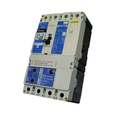

4- pole 60 Amp - $2700

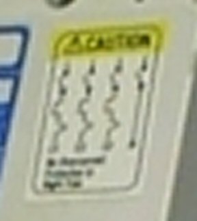

Now, back to that picture: thats a very flash circuit breaker you've illustrated, with all sorts of settable parameters, which is why it's expensive. But I don't think it's four pole; looking at the little diagram the righthand-most line is solid, so I think it's a three pole breaker with a convenience neutral path, which makes it easier when mounting the thing in a box.

As has been noted that particular breaker does not switch the neutral, it just passes through, I suspect it is GFP breaker with internal CTs that would explain the neutral passing though, and the price, to some extent. (I bet that price was 'list' not the out the door price)

. . . thats a very flash circuit breaker you've illustrated . . .
How flash is very flash? :)
iwire said:
As has been noted that particular breaker does not switch the neutral, it just passes through, I suspect it is GFP breaker with internal CTs that would explain the neutral passing though . . .
I don't think you guys are correct. Looking closer, it appears that all four poles switch, but only the three lines have overload sensing.
To wit:
