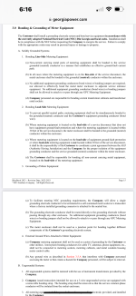

Just looked up the latest Georgia Power blue book requirements, and they have changed their position on GEC’s, but still do their own bonding as far as ct cans and such.
(A)(1)(C) and (A)(3)(B) both have a typo that amounts to a double negative that would actually allow additional binding jumpers and wires to pass through. It would be funny to hold them to it.
