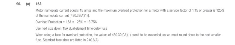

430.32
There is noting in 430.32(A)(1) that allows "next size up" so you would need to round down however 430.21(C) does provide for situations where (A) is not sufficient.
Where does the code say you cant round up a fuse for motor overload protection?
When the code language says;
This device shall be selected to trip or shall be rated at no more than the following percent of the motor nameplate full-load current rating:
