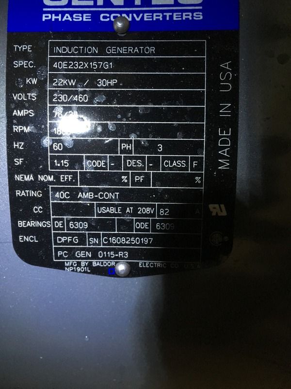

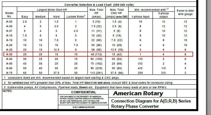

Gentlemen, w have a rotary phase converter, spec's highlighted in red>>>
The customer has no idea what loads it will serve , other than it will be doing many portable pieces of 3 ph equipment in the near future, all of which will assume some sort of pin/sleeve and/or twist lock 3ph receptacle outlets on a b-board close by
Reading 455, it would seem there is much predicated on 'loads served' , yet little for an install not

My Q is, what HP and amperage would a disco before the converter need be? I'm thinking 240V fusible w/ aux contacts

That is what I was thinking but then I was confused by the #6 wire from Panel to idler(whatever that is)
The freely rotating motor in a rotary converter is also called an idler. The whole converter includes in addition at least one capacitor and something to spin up the idler in the first place.
But I cannot see any reason for smaller wire in that picture except possibly for a neutral in a wye supply that is only used for the spin-up motor or the controls. Or else an EGC.

I did call the company tech support with the model # , and they said place it on a 90A breaker .
They also claim it can do up to 15HP
so it seems they are pulling #'s of the 'Max total CNC ' collum , if that helps size it to 455
