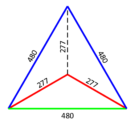

One way to see in it a real form is to drive a stake in the ground (call this "A") walk 277 feet and drive another stake at this location. (call this "B") Go back to the first stake ("A") and at walk another 277 feet at a 120 deg angle and drive a stake here. (call this "C") Measure from "C" to "B"

If you had an isosceles triangle with two sides equaling 1 and separated by 120 degrees your missing side would be equal to the square root of 3 or 1.73.
I think it has to be an equilateral triangle, an isosceles triangle may have only two equal sides which throws off the angles.

An equilateral will have all three sides the same therefore the angles would all have to be 60 degrees. An isosceles will have two sides the same which would allow one angle to be 120 degrees.
