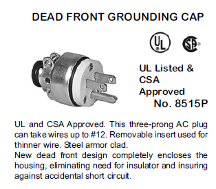

What do y'all think of this? I have always been uncomfortable with it. I googled it and found this:
https://vetco.net/products/armored-cable-mc-cable-male-ac-plug-nema-5-15p
I never really looked at he description of these things and was surprised says AC and MC, although I didnt try to find the actual listing documents. Seems like the armor should bond to the cap, although if the armor was bonded on the other end it wouldnt be necessary I guess.....

I have seen those type of caps called "armored", so perhaps someone down the line mis-described that as being used for armored cable. Anyway, my question wasnt necessarily about that specific item, so in general Is it ok to put a cap on MC? If so, what type would you use?
I did this twice yesterday: It was two refrigeration unit sets with remote compressors. The evaporator took power and had a 5-15 female that sent controlled power to the compressor. They had them set up with SO cord which I didnt deem accetable to I replaced it with MC. I didnt want to get rid of the recep as it was in a really difficult space and that whole task was not really on my to do list anyway... Im not having trouble sleeping over it, just curious.

I will say I have seen them on AC/MC or 3/8 flex before. Not sure if listed for it or not.
Not sure why you wouldn't just use flexible cord if you are going to have a cord cap anyway either.
Seen them called "armored" cord connectors before - presumably because of the mostly metal outer housing. They typically will have a bonding contact point that bonds that outer metal housing to the EGC pin of the assembly.

I did try to find the documents and came up empty handed. All I found was the catalog page it was shown on.
http://www.philmore-datak.com/mc/Page 204.pdf

Its UL listed, not sure what UL listing it is.
Manufacturer page pic.

Rebranded product? Counterfeit listing? Only ones I have ever seen that look like that used to be "Eagle" products, which I think was taken over by Cooper, and then Eaton.
It's from the Philmore catalog. A rebrand I dunno. I only looked for that item # by philmore.
Many many things are rebranded. "Pentair GFI" made by Siemens, etc etc etc and etc.
There's only 3-4 LCD/LED panel makers in the world, yet about 250 different brands of LCD/LED TV's being sold.

You said manufacturer page pic. I don't know what Philmore is, but guessing a distributor and not the manufacturer of whatever this product is. Could have some products they sell "rebranded" with their own private label though. Kind of like how Grainger has "Dayton" name on a lot of products they sell, many of those are same, or very close to same as other name brand products and made at same places, just with any minor changes in specs and different labels applied.

Could be either.
LKG Industries, Inc.dba Philmore/Datak/Carter Craft/Pfanstiehl imports, manufactures and markets thousands of electronic accessory items for use with consumer items, in categories such as Audio, Video, Television, Telephone and Personal Computers, as well as connectors and switches for use in manufacturing
