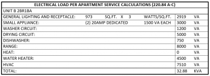

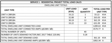

Just created this not too long ago. This is my typical process to go about sizing for multifamily panels and service.
  • Sizing dwelling unit panels:
  • Calculate dwelling load for service:
  • Combine dwelling unit loads and apply demand factor associated with number of units on the service.
  • Calculate House Panel loads using non-dwelling unit demand factors.
  • Combine Residential and Commercial demand amps and (kVA) to service.
