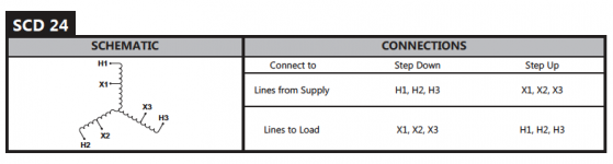

I recently bought a vacuum Pump from Canada, the Voltage is 585V I need to get it stepped down and cant find a transformer, and ideas on how to get it to 480V?
Yes I wrote that the wrong way I need to get 480 to 585 .
3 phase 60 hz 38 amps

Negative. The opposite is needed. The goal is to power a 575v motor from a 480v source.The autotransformer below, or another one this manufacturer, might be suitable for powering the vacuum pump:
https://canadatransformers.com/45-kva-autotransformer-rc45j1-h.html
Even when 'primary' and 'secondary' are labeled as such?
Added: I looked and found their 480v primary auto-transformers only have lower-voltage secondaries.
