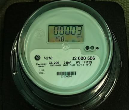

I have a 5 jaw meter on my own home and it has none of the conditions you describe.
The 5th terminal is used in some meters to provide 120 volt power to the balance elements internal to the meter.
I work as a meter tech for a utility and the only time we use a 5th leg is for the120/208 service if you did not ground 5th leg you would have 104v on each coil in the meter not 120v loosing revenue. The other style meter in our area is for the night rate meter,at 11:30 the 5th leg is energized so it will heat your water on the cheaper rate. Is your meter a form 2, 240 or a form 12 which has a 120v coil?
Good question, where would we find this information? Is it visible on the front of the meter.
