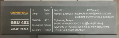

I don't recall seeing a circuit breaker before with a 60C/70C rating before. This circuit breaker is on a generator. I've seen them marked with the ambient temperature rating for the circuit breaker trip curve but this looks like it's referring to the lug temperature rating. I'd assume I'm limited to the 60C ampacity column. Thoughts? Any information would be appreciated, thanks.

The NEC would be either 60° C or 75° C so it's either mislabeled or it was designed for use not under the NEC. Those numbers would be the temperature rating of the terminals. The 40°C would be the ambient.
Here is a more clear picture. The 40° appears to relate to the UL Interrupting rating.
The terminations are 60/75

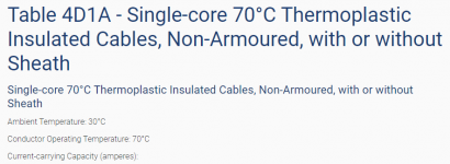

Interesting. I found others marked 70C of this type. They're UL Listed. I do see that the UK has some 70C rated cables.
The pictures with the 70C marking say that are UL listed but do not say that they are listed to a product standard that applies in the US.
The label on the breaker itself says the breaker is listed for compliance with US and Canadian product standards.

Thanks I didn't catch that. Does that mean it shouldn't be used in the US?
It does mean that. Where a product is required to be listed by the NEC, it must be listed to a product standard that applies in the US.
However the 2023 code is the first edition of the NEC that actually requires breakers to be listed.
