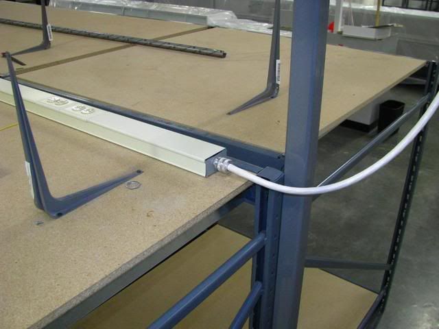

I was at a jobsite today, the project is close to completion.
I have spoken to the contractor and the National Chain people about the topic you are going to see in the pictures.
Please tell me through code citation if these pictures are code compliant.
Picture 1
There are drop cords from the ceiling boxes, down to the shelving wired to a pendant box, where the electronic merchandise will be displayed.
Is this a permitted pendant?

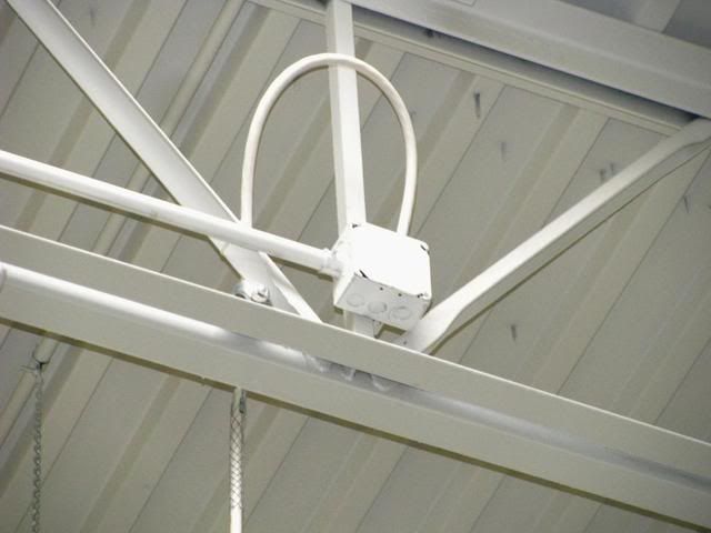

Picture #2
Here is another pendant box at a different shelf location
This is the same store, but a different type of installation. The cord is supplied from a box up by the ceiling. The cord enters the box via a fitting (ceiling box), which is permanent wiring. The cord does have strain relief up at the ceiling.
Down at the shelving, the cord is hard wired with the proper fitting into a fixed Multioutlet Assembly. The shelving is bolted into the floor with at least 8 bolts.
Is this a permitted installation.

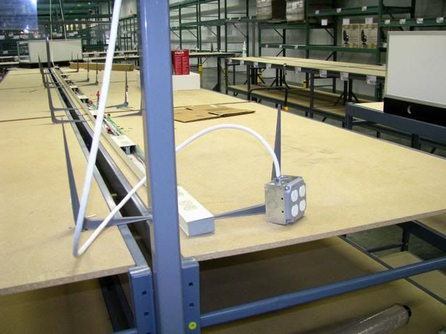

Picture #3

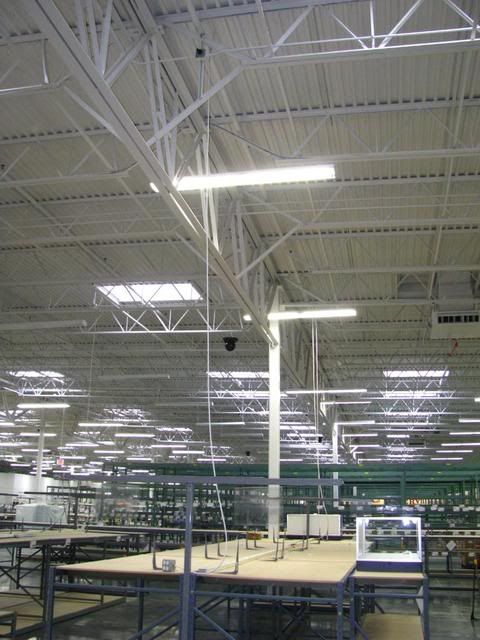

Picture #4

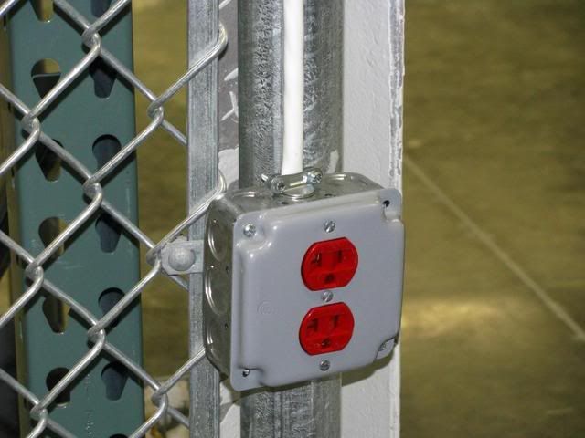

Picture #5
I'm thinking a pendant should not be fixed at the end. 400.7, this appears to be a situation where permanent chpt 3 wiring methods are required 400.8. I have concerns regarding some of the connectors maybe 400.10, also I guess the cord is subject to physical damage.
(H) Pendant Boxes. An enclosure supported by a pendant shall comply with 314.23(H)(1) or (H)(2).
(1) Flexible Cord. A box shall be supported from a multiconductor cord or cable in an approved manner that protects the conductors against strain, such as a strain-relief connector threaded into a box with a hub.
This violation may also apply to some of the other pictures.
The box at the ceiling and the box at the work/display surface are fixed then you have a violation of 400.8 (1) - As a substitute for the fixed wiring of a structure. Possibly a violation of 400.8 (7) - where subject to physical damage. Also for picture 1 violation of 400.10.
What size is the OCD on the circuit? What size is the cord conductors? Possible violation of 250.122 (since you have fixed wiring and the EGC may not be properly sized). (This shouldn't matter since the obvious problem is 400.8 but I was trying to think of all the sections that may apply:roll:)

#1 & 2 - Pendant boxes not suitable?
For the boxes in photos #1 and #2, there may be a problem with the boxes not being intended for pendant use:
110.3(A)(1) Suitability for installation and use.
(And OSHA 1910.303(b)(1)(i) similar wording, & 1910.303(b)(2) - listed and labeled equipment shall be used or installed in accordance with the listing and labeling - UL etc.)
