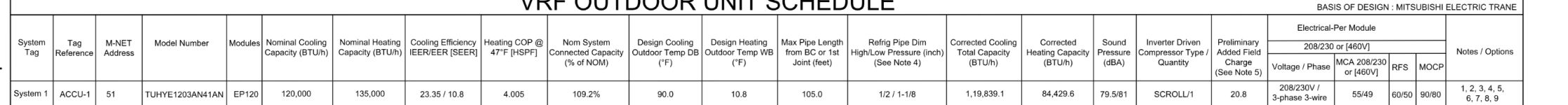

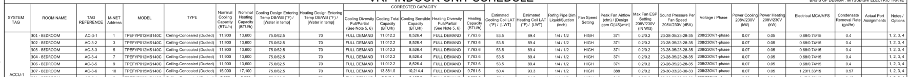

Would an AC unit and it's associated condensing unit always be on the same circuit? Circuit info not on drawings but looking at the electrical data on mechanical schedules they each have different power requirements.
Don't know what type of unit this is. It looks like ductless or ducted mini splits with a condensing unit. So ACCU-1 would be the condensing unit. Then it looks like you have 6 heads AC-3-1 to AC-3_6
Most straight Mini split (one condenser and one indoor unit) some are wired with separate power to each unit and some the indoor unit is fed from the condenser.
I have not wired any units with multiple heads, but I suspect they would have their own power supply separate from the condenser
