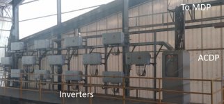

I've a question about cable sizing for big MW PV Systems.
For example the following PV System.
PV Capacity 940,680 Watt
13 x Huawei SUN2000 KTL 60 KW
2808 x Seraphim 335 Wp Poly
156 Strings
AC Side
All Inverters are connected with an ACDP by NYY Cable 4C x 35mm2 N L1 L2 L3
All inverters are grounded by NYA Cable 1C x 16mm2 from inverter to grounding bus bar in the ACDP
Average distance from Inverter to ACDP 10 Meter
The ACDP is connected with a MDP Distance from ACDP to MDP 60 Meters
How do I size the necessary cables for L1, L2, L3 and Neutral and Grounding for the connection between the ACDP and the MDP?
The AC cables will be in AC Cable ladders inside the building
Surrounding temperature around 30 degrees Celsius
I hope someone can explain this to me.
Thank in advance for your contribution
Kind regards

Thanks for your replay. ACDP stands for Alternate Current Distribution Panel.
So all inverters come together in the ACDP. From there the ACDP is connected to the MDP (Main Distribution Panel)
NYY, NYA stand for different kind of cable types. For example.
