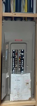

Does anyone know if Cutler Hammer residential 'CH' panels from the 80's -90's era can generally be converted from main lug to main breaker like other brands?
I am able to find any info on this, I have 200A main lug one that needs a 200A breaker.
Its not a 70's era 'split buss'.
Thanks in advance.
I think many of those can have a backfed 125A in two corners where there is a hole for a hold down clamp. If you need 200A I don't think that is possible. The stab limit in those is usually 140A and I think that includes the adjacent stab.
CH didn't seem to make those quad breakers to put 150 or 200 amps across 4 stabs like some other vendors.
Your best bet might be to use the guts and front cover of a new main-breaker panel.
The box doesn't look tall enough for a main breaker. I bet if you compare the height of this loadcenter and a new loadcenter the new one will be at least 6" taller.
Yeah thanks everyone for the ideas. I am looking into Larrys idea and if there is not room I'll replace the panel.
