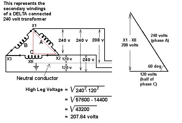

If you only need 3 phase for one piece of equipment I would suggest going with 240/120 Delta. The poco (I?m guessing PG&E) can add a small transformer along side the existing single phase transformer to obtain the 3rd phase. You can then install a new 3 phase service and feed your existing service off it along with installing a new 3 phase circuit for the equipment. If the existing transformer feeds other customer you save the cost of installing a dedicated transformer just for your building. If you do go 3 phase wye what effect will it have on any existing 240 volt equipment in the building? I'm not sure if the poco or AHJ will let you keep the existing 120/240 service and add a 3 phase service with the same voltage.
What is this, 120/240 delta you speak of? I've read your responce but this peice of it sort of slipped by me. I've always considered deltas to be semetrical, otherwise it would be shaped like a sling slot, not a delta (triangle). Sometimes I hate knowing what words mean, it doesn't seem to help.

I want to thank you very much for the schematic, that's very helpful.

I think the open Delta would be an ideal solution.
If you install a Wye, you might not like the reduced performance of the water heater (it might be a water warmer, lol).
You might also get into derating issues on existing circuits with a Wye. 2-hots and a neutral would no longer be 2 CCCs but would become 3 CCCs. If you had a conduit with 6 hots and 3 neutrals, your derating would go from 80% to 70%. With THHN conductors that might not be an issue, but it is something to look for.
The Delta seems to be an ideal solution (oh yea, I already said that).

You are only partly correct.
Your diagram is not a simple DELTA configuration.
It is a very specific delta where one winding is center tapped. The resulting configuration is properly called a 240/120 3-phase 4-wire system, although it goes by many other names including: High leg delta, wild leg delta, center tapped delta.

Your point being? Odds are better that there may already be a portion of a service like it there, if there is 3 phase in, and being used in the area. (Say right out front) And as Curt Swartz pointed out - there may already be other equipment in the building for 240v as opposed to 208. So a delta high leg as he mentioned is still suitable for 240 3-wire, as well as four wire.
