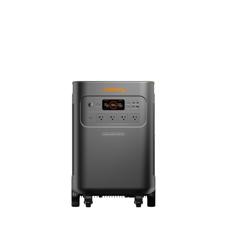

Wonder if any of these would work. Probably not as you have to plug in the loads and we'd need to feed a trailer panel.
I'm thinking that the solar panel associated with the battery system will not fully charge the battery. Shanties have electric heat in the winter and AC in the summer running 24/7.

How much power is being used max, and what is the average per day? You could get this and plug it into the generator to charge it, or take it home each day and plug in to recharge. They offer a transfer switch with this one which you'd probably need if you want to connect the trailer in and not just be using extension cords all over. If you need 3 phase for the trailer panel, then it will be even more expensive. Solar charging is probably not cost effective for this, especially if you can move it and plug in to recharge or even if you have to use a generator to charge it.
is 7000W enough for max use and 5KW-hr's enough for the day? You can add more battery if needed, but cost and weight just goes up.
